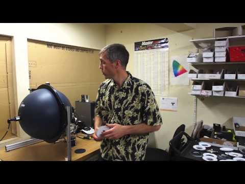

That’s why Mtbr works so hard to demystify LED output.  The ultimate test is using an integrating sphere to measure light output. This piece of equipment costs about $20,000- $100,000 to purchase and requires a trained technician to operate. This year, Mtbr is using the integrating sphere of Light and Motion and Lezyne to measure lumen output.  We are present during all measurements and we will cross-check their work with each other.
To complement these lumen measurements, please check our Beam Pattern Comparisons of these lights.
Lumen measuring process using an integrating sphere with Chris McCaslin.
As you can see, it is not a simple process and that is why so many light manufacturers do not measure their output.  There are very few independent labs around this country too that can do this work.
We realize of course that Light and Motion is a manufacturer and they are testing competitors’ lights. But we have evaluated their process and were present during testing. Furthermore, we are double-sourcing this year by testing at another manufacturer called Lezyne and cross-checking their work. We have already compared four lights that they each measured and the results match up within 1-2%. Finally, this is just a piece of our lights testing and is supplemented by our own Mtbr Lux lab testing and light beam image data.
These lumen readings were recorded 31 seconds after the light was turned on. This is according to the FL-1 Flashlight Standard that specifies lumen measurements to be recorded 30 seconds after the light is turned on. The FL-1 Flashlight Standard was created so manufacturers have a standardized method of measuring lights and making claims such as brightness and waterproofing. Some light companies are using the FL-1 standard and fighting for its use in the bike light industry. Learn more about the FL-1 Flashlight Standard HERE.
