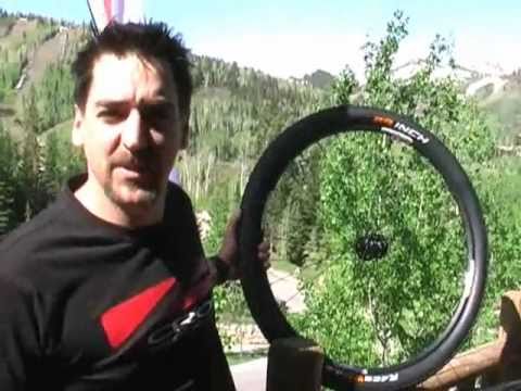

Marius, the general manager at Acros, shows us the new 29er wheels.
Acros 29er Wheels
  • 29-inch wheelset
  • Rim made of 7,000 aluminum shotpeened surface
  • Special profile hump to securely tighten tire in fit
  • Weighs 1,580 grams
  • $799 US
  • $850 US for RTR “Ready to Ride” – Wheelset comes with tire, tube and wheelbag
