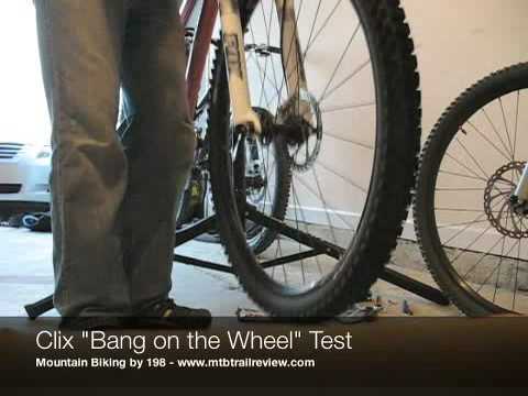

At first, I just started playing with the Clix in the RST fork. To my surprise, I was able to hold the heavy RST fork in one hand while quickly removing and latching the hub with the other. It was almost too good to believe! Was this really a QR that wasn’t going to require re-tensioning and could be operated with one hand? To find out, I installed the Clix QR on the Fox F29 of the Ellsworth Evolve.

Like I said…it is pretty easy to install. Once the QR is installed, there is no longer any need to adjust it ever again. This one handed operation is correct every time. That is the beauty of the entire system. You no longer have to adjust the tightness of the skewer every time you reinstall the wheel.
As you can see from the videos, it is almost a one-handed operation. Your other hand is normally needed to help the rotor into the caliper or to make sure the QR is fully seated. The big picture here is having a correctly adjusted QR every time.
Another great feature of this system (that you can also see in the video) is that if the lever ever releases while riding, the wheel can not leave the dropouts. I released the lever and hit the top of the wheel repeatedly, and the wheel never came close to falling out of the dropouts.
