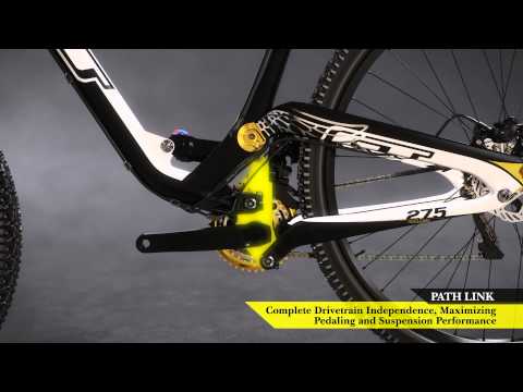

The backbone of the entire Sensor platform (which also includes the $9220 Carbon Team, $7050 Carbon Pro, and $3800 and $2820 alloy versions) is what GT calls its Angled Optimized Suspension or AOS. The big picture idea behind AOS is that by utilizing a high pivot point, the rear wheel moves upward and backward, which gets the wheel out of the way of obstacles more effectively, making for a more capable and playful ride.
At the same time GT has countered the most prominent complaint leveled at high-pivot designs (poor uphill performance) with what it calls PathLink, where pedal feedback is minimized by controlling chain growth and isolating rider input from suspension performance. You can see a nifty illustration of all this in the video below.
