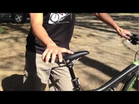

Last week I was lucky enough to test out the new Kronolog adjustable seatpost by Crank Brothers. Lets talk about the seatpost itself. Its made of aluminum, 405mm long, has 5 inches of travel (can be set up for less,) comes in 30.9mm and 31.6mm (soon 27.2mm,) comes in red/black and black/black. The warranty is a 2 full years and the msrp is $300.

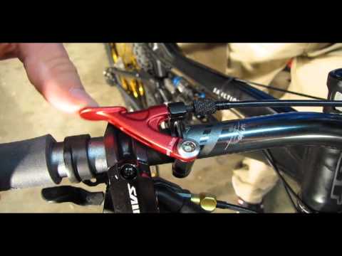

Let’s start with the lever. The clamp has a hinge on it so there is no need to take off the shifter, brake lever or the grips; you simply put it on. The bolt can be tightened without having to re-adjust the shifter as well since the bolt is position out of the way. The thumb lever itself can be placed in a natural position and feels like a shifter. The lever is also really easy to push on. I understand some of the seatposts out there need quite a bit of force to activate.

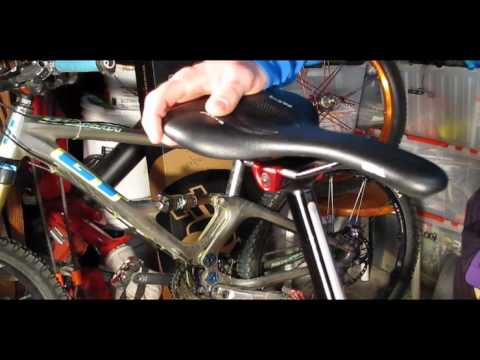

The seat clamping mechanism seems to be bomber too. Crank Brothers took the extra step and the Kronolog passes even the CEN standards of Europe. I understand this is the only adjustable seatpost to have ever passed. I watched a video of this machine forcing down (I believe 270lbs) on the nose of the saddle 100,000 times. Not only did the Kronolog pass the test, it passed it 2.7 times the European fatigue standard. The saddle was still on there tight with minimal play
What about failure and the post getting stuck in the down position? If, for some reason the rider were to take a big fall and rip out the cable for the seatpost, the Kronolog is still adjustable. Simply open the cover on the post and unlock and unlock the post manually. How simple is that?
Crank Brothers put the locking mechanism of the Kronolog on the lower end of the seatpost. It sits right above the seat tube of the frame. I see two advantages of this. One, I donʼt have to see the cable climbing up the seatpost and two, when the seat is lowered, the cable doesnʼt flop around. While there is less than a centimeter of play in the cable, it is unnoticeable and virtually unseen.
