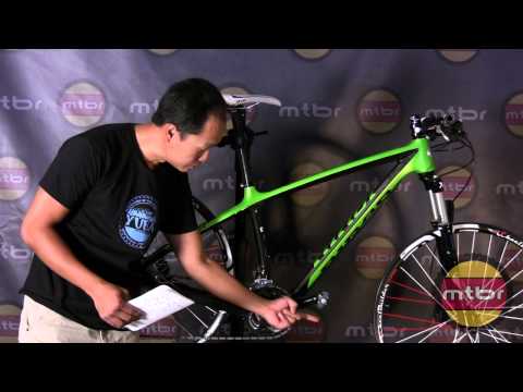

The noise
As you can see in our first video, we were initially concerned about the noise by such a hub with so many points of engagement. We let the hub break in and we put the wheel on many bikes. We learned that the hub gets quieter over time.. Also bikes with big carbon tubes can amplify the sound of the hub as they act like a sound box.  The hubs mounted on Enve rims are loud but they’re really on par with Chris King and DT Swiss hubs. What is distinctive though is the noise is at a higher frequency since the ratchet click is more frequent. It may seem louder at first but it’s really just a higher pitch.
