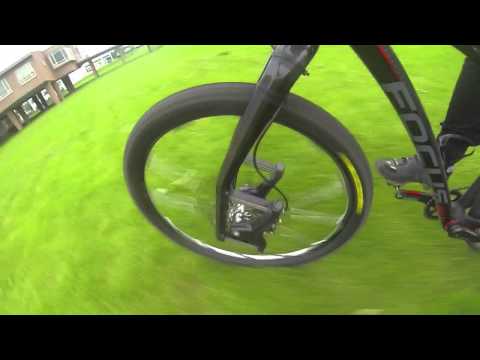

Hard to imagine? Well, not for four friends from Iceland who showed up at Eurobike to show the world their new Lauf TR29 fork, which they claim weighs just 990 grams and provides 60mm of progressive suspension.
They call the technology the Lauf Spring System, which is better known to the rest of the world as a leaf spring. In this case six horizontal plies of S2 glass fiber on each side of the fork flex to provide suspension that, according to lead engineer Benedikt Skulason, is softest and most sensitive during the initial phase of the travel, more linear in the middle, and stiff at the end to prevent it from bottoming out.
Video: Action of the 60mm Lauf fork.

“It’s also completely maintenance free because it has no moving parts or oils,” added Skulason, who previously worked for a company that made prosthetic feet. “The springs are also very tough. This S2 glass fiber material is used in tank armor so it is really strong against sharp hits like from rocks.”
The fork is designed specifically for 29er hardtails, is compatible with 15mm thru-axles, is optimized for 180mm rotors, has 45mm of rake, measures 487mm from axle to crown, and comes in three different stiffnesses to accommodate riders of different weights — 110-165 pounds, 155-210 pounds, and 200-245 pounds. Estimated retail price is $1,000 and they hope to start shipping in July of 2014.
