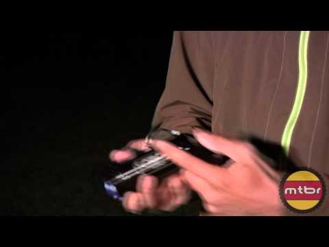

Lights Shootout Video
The Six Pack is a stubby, monster flashlight. It packs 6 Cree XPGs in one light head with a self-contained battery. It is an ultimate flashlight. It’s got a big beam pattern with no hot spot and it can run 3 hours in high mode.
It shares the same charger as the tiny Exposure Joystick so charge time grows to a very lengthy 24 hours with a fully discharged battery
Craftsmanship is typical British so expect only the best machining, CNCing and laser etching. We like the ergonomics of this light except the off switch which requires a long 3 seconds of pressing the small button. If you get it wrong, you’ll fall in the dreaded flash mode.
