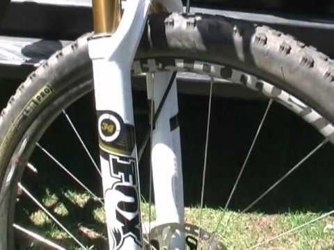

Fox Racing Shox 34 29er Fork, Float Ti and RP23 with Adaptive Logic
Bike Press Camp Forks Product Launch Video
Jim Noonen from Fox Racing Shox shows us the new 2012 34 29er fork with 2 version, the Float Ti and the RP23 with Adaptive Logic.
Fox Racing Shox 2012 34 29er Fork with 2 Version:
  • New for 2012
  • 34mm outside diameter tube
  • 29er only
  • Float model 140mm travel RLC
  • Also Available in Talas with travel adjust 140mm and 110mm
  • Standard 15 QR skewer – no other axel options
  • Stout, robust platform
  • Available August 1st
Fox Racing Shox 2012 Float Ti
  • New for 2012
  • Investment cast titanium crown steerer
  • 64 titanium
  • 80mm, 100mm, 120mm travel options
  • 15 QR axel option
  • Target weight of 2.9 lbs – 3.25 lbs
  • September 1st
Fox Racing Shox 2012 RP23 with Adaptive Logic
  • New for 2012
  • Dedicated firm pedaling platform
  • Descend mode nob can vary the amount of low speed compression damping
  • Darker Kashima
