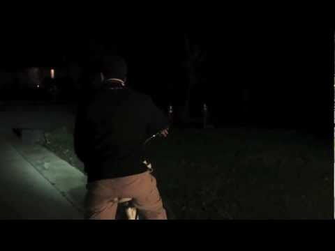

This is a pretty ground-breaking light. It uses a speed sensor magnet on the wheel to vary the light intensity with the speed of the bike. The faster you go, the brighter the light is. It’s all configurable of course so the rider can define what ‘fast’ is and how responsive the light changes intensity.
Obviously, this kind of variable brightness can save battery and extend run time. But here is the secret. By using speed sensitive mode, it is assured that the light will only be at max brightness for a short duration. And it is known that there will be max airflow (default 15 mph) when the light is on full bright. The peak battery demand won’t be as prolonged either.  So it looks like they’re able to drive the LEDs very high during these peak durations.
Full Beam is using the human eye’s ability  to adjust to lower light. The eye is a powerful device in low light but it needs a few seconds to adjust. So lowering the light level gradually on a prolonged climb or during a stop is ok since it gives your eyes a chance to adjust and be more sensitive.
The light defaults to a few hundred Lumens and it ramps up to about 3000 Lumens at 15 mph. Then it drops down (but slower) when the speed goes back down. It is pretty amazing so far because the number don’t seem like they add up. Insanely bright, light, long run time seem to be achieved in this small self contained light.
