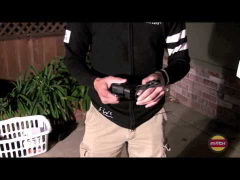

Strengths:
  • great value at $199
  • good battery and charger for the price and upgrade paths are available
  • CNC’d head unit is A+
  • bar mount and helmet mount are excellent
  • helment mount crash detach feature is a good safety feature
  • US made and US supported.
  • connectors are bulletproof!
Weaknesses:
  • light output came in a bit lower than expected
  • ultra long wires are not ideal
Bottom Line:
If you want a basic, handmade helmet light with a traditional design, this is a good solution. You will be blown away by the light output possibility of a single helmet mounted head unit.
