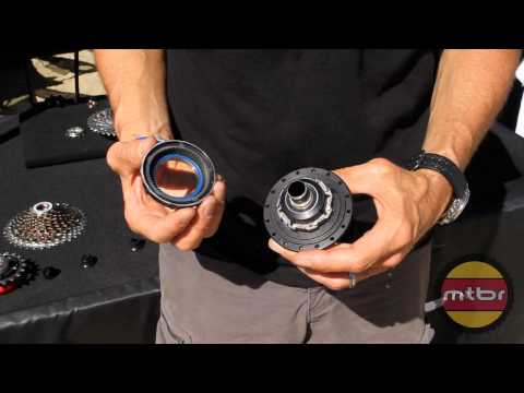

But after talking with Russell Kappius at Sea Otter today, he explains that these hubs are a product of 4 years of R&D. Another thing I learned about Kappius is that basically the whole company races. Russell himself loves racing and comes from an engineering background. He is the owner and inventor of Kappius Components and although the hubs were indeed initially created as a cosmetic compliment, they have some real and tangible benefits and features.
The most attention grabbing feature is the amazing 240 points of engagement that these hubs boast. At more than double the closest competitor, how does Kappius achieve this? He uses 60 teeth, 8 pawls, those pawls act in pairs, so 4 pair, the pairs engage at a quarter tooth, so every every quarter tooth turn, you get engagement. Kappius hubs feature a 1 and half degree scalar angle of engagement vs. 3 degrees on other brands.
What does this all mean to you, the rider? It means the most instant engagement you will find. Instant engagement, maximum power.

    Eight pawls translate to extra drag and noise when coasting, not maximum power. You get maximum power if you just keep spinning smoothly, without any need to engage.
