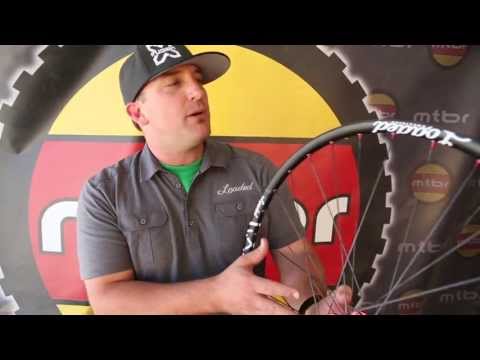

Michael Mulder from Loaded Precision shows us the X-Lite Ultra XC wheelset that weighs under 1500g. Also featured are the AmXc trail/enduro stem in 70mm, 85mm and 100mm designed for a flip-flop 6° or -6° compatibility and the AmXc lock-on grips with its unique rubber compound that’s hydrophobic and oleophobic resistant. Loaded Components was also showing off some of their products on this Ibis Mojo HD on the back of a mini-Hummer.

X-Lite Ultra Wheelset
X-Lite wheelsets feature Loaded’s True Bead Technology rims- our very own Tubeless System that provides an efficient interface between the tire and rim for easy installation and inflation. With a reinforced internal beam to provide torsional rigidity, the X-Lite TBT Rims provide the rider the ultimate balance between weight and durability. X-Lite Wheelsets feature our tubeless X-Lite Ultra rims measuring 19mm edge to edge, matched to a quad-butted seamlessly drawn spoke. X-Lite aluminum spoke nipples are matched in 7 different colors to the X-Lite series hubs. Hubs are convertible to 9mm or 15QR up front, and 9mm or 12x142mm configuration in the rear. All X-Lite wheelsets come tubeless ready and include skewers.
29-inch Specifications:
  • 19mm Rim Width
  • 32H
  • Front Axle Options (Included)
  • 15mm QR*
  • Standard 9mm QR*
  • Rear Axle Configuration (Included)
  • 135mm Standard QR*
  • 12x142mm Thru Axle*
  • 1561g weight (Fr&Rr)
  • 3 Dual Action Pawls
  • 24 Continuous Points of Engagement
  • 6-Bolt Disc Mount
  • 29″ Diameter
  • 1561 Grams (Set) Weight
  • $799.99
