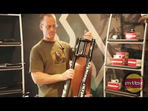

Manitou is another division of the Hayes Bicycle Group that is fully supporting the 27.5 movement. Highlighted here are the Manitou Marvel, Minute and Dorado mountain bike forks. The Marvel is XC oriented and comes in 80, 100 or 120mm of travel. The Minute is trail oriented and comes in 120 or 140mm. The Dorado is now available in a 27.5" version that is all new and has 203mm of travel.
In this video, Ed Kwaterski (Chief Engineer and Product Manager) of Manitou shows us the details of the 2014 Marvel, Minute and 27.5 Dorado forks.

Manitou Dorado Pro
"The new Dorado Pro is an engineering masterpiece. 7050 legs, inverted construction, dual-chamber air spring, TPC+ damping (with independent high- and low-speed compression), hydraulic bottom-out and top-out, and Manitou's patented HexLock 20mm thru-axle add up to the most advanced downhill fork ever."
- 180, 203 Internally Adj. (29'er 175mm) Travel
- 6.5lbs
- 1 1/8" Aluminum Steerer
- Forged Hollow Round Bore Crown
- Matte Black Ano Crown Finish
- TPC+ Compression Damping
- 7050 Aluminum Leg Material
- 26, 27.5 and 29 Wheel Size
