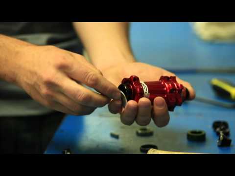

These upgrades can be done by the consumer now since there are a ton of awesome How-To videos on the Easton website.
Video: Replacing Hub Bearings
Video: Convert from QR to thru-axle
