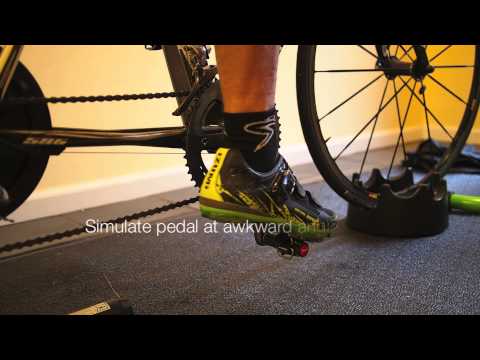

Video: Demonstration of click in and out action of the S-Track Pedals
The S-Track was designed to have a very reliable, consistent and positive click in and out mechanism. And at the end of the day, that is the ultimate test of a clipless pedal. How is the clip in and out action of the pedal? How easy is it to find the pedal and click in? How consistent is it when clicking out? We rate the S-Track the highest in all these categories. The spring is tight and positive and it gives a very audible click when clipping in and out. The cleat is made of a very hard metal to give it that positive feel and maintain durability over the years. Yet, they were able to merge rubber material to it to improve the mating with the pedal.
