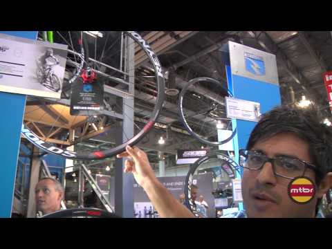

Rob Aguero shows us how Reynolds has used their years of carbon fiber experience and technology and applied that to their 2103 mountain bike wheel line. New for 2013 is the 650b Carbon and Alloy, the 29er Carbon and Alloy and the 26″ AM carbon wheelsets with the Reynolds all mountain hub.
