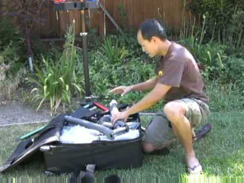

  • Includes travel case + WCS headset
  • Disc or V-brake compatible
  • Case size: 8.5″ W x 26.5″H x 31″L w/ wheels

    francois: That is sweet. The really amazing thing to me is the travel case. I think you can check it as “bike parts” and get away with it.
    Anyway, I think the Ritchey guys said that the joints were stronger than welds when locked into position on the Breakaway bikes,which is another amazing thing about the bike.
