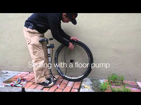

Mounting the wheels tubeless with Purgatory tires

We’ve ridden these tubeless twice now in two days. The setup above is a Specialized Epic with tubeless Purgatory tires at 22 psi. Rider weight is 150 lbs and trail conditions were hardpacked, hero dirt singletrack and fire roads. The wheels performed flawlessly as the setup never lost air or burped under hard cornering. The wheels felt laterally stiffer than our 2012 Carbon Control Trail Rovals. Even thought the outside rim diameter is about the same as the previous year, the lack of a hook in the rim gives the wheel higher internal width. It is a bit early to tell but cornering and throwing the bike in and out of corners felt good.
A note about tire pressures:
Specialized does not state a minimum psi for these wheels. That is really a function of rider weight, riding style, terrain and tire fit. Mtbr will venture low into psi testing to see if these hold a tire as good as hook-bead rims. But please use common sense when setting your tire pressure. Start high and lower as you see fit with your riding experience.
So the real question here is do the rim sidewalls with no inner groove perform the job of holding the tire in place? Will they hold a tubeless tire secure and prevent the dreaded ‘tire burp’? A tire burp occurs when a tubeless tire experiences enough lateral force that it folds over and lets air out between the tire and rim interface. This usually is accompanied by a spray of sealant, a burping sound, and the thud of a body hitting the ground.
To expedite our testing and to save our carcass from the pain of crashing, we employed the crude but useful C-clamp test. First we set our tire to 12.5 psi (since low pressure is where burping occurs). Then we tried to yank the tire out of the rim. Nothing happened. We then got a c-clamp and placed it on the tire right above the rim. We tightened the c-clamp and wiggled the clamp and tire in an effort to get the air to leak. Nothing happened. We repeated this process again until the C-clamp was completely tightened with both sidewalls locked together. We wiggled some more to let the air escaped and we could not break the seal.
So this give us quite a bit of confidence with this new rim design and technology. It appears that a good rim, a good tire bead and a tight fit between the two are the crucial elements for a secure tubeless seal. And if tire and rim interface are secure when tubeless, using tubes will be no problem at all.
