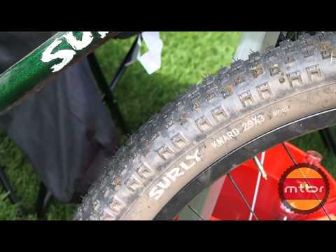

Surly wondered how big of a tire could they make with a no offset fork. Using standard hubs and cranks, what would be the biggest tire they could use? The Krampus was developed around the Surly Knard tire, a 29er tire with a 3″ width. The tread design was inspired by moto dirt bike tires and the outside diameter of the Knard is 30.5″. The Knard 29×3 weighs in at 820 grams and is available in 120tpi folding or 27tpi wire bead casings.
Complete bike weight (for a large) is about 30 lbs and the weight for large frame is about 6 lbs. The Krampus features the strongest tubeset that Surly has every produced and it is also one of the stiffest frames that Surly makes. The Krampus features Surly 4130 CroMoly steel and a 73mm bottom bracket.
