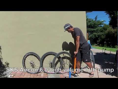

One of the key issues with sealing tubeless is the tire needs to be pressed on to the rim so all the air won’t leak out when it is being inflated for the first time. This tip below is handy  even though the example is not bicycle tires.

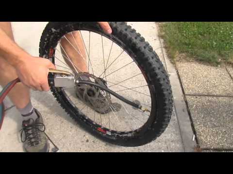

Here is another great video demonstrating some of the proper techniques for tubeless. He is using a tubeless conversion kit so it is essential that the rim and tire fit tightly. If it is loose, that combination may not seal or may be dangerous on the trail
Some of the techniques are: ensuring a clean tire bead, using soapy water, pushing the tire sidewalls to the rim, removing the valve core, submerging the tire in water to find leaks.
