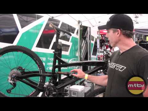

Chris Conroy of Yeti Cycles shows us the new All Mountain Chasis, currently known as the SB-66. Featuring the new Switch Technology, an eccentric link above bottom bracket that creates a stiff pedaling platform in the front end and gets more plush further into travel.
Yeti Cycles SB-66
  • New trail bike
  • In development for the last 2 years
  • Good pedaling platform
  • Switch Technology – Eccentric link above bottom bracket that creates a stiff pedaling platform in the front end and gets more plush further into travel
  • Slack head angle – 67° head angle with a 150mm fork (66° with 160mm fork)
  • Low bottom bracket
  • 12 x 142 rear axle
  • Custom molded integrated chainstays
  • Optimized stand-over height
  • Integrated tapered headtube
